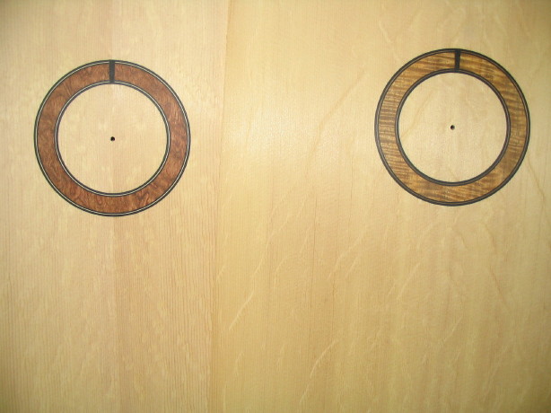

I've just completed the rosettes for these two little guitars I'm making (call 'em double course steel string tenor ukuleles, or double course alto guitars). One is bubinga with maple and black fiber purfling, and the other is koa with koa and black fiber purfs. Here they are:
A technique I learned and use for gluing in rosettes is to dry fit them and wick in CA. Along with wicking it in from the top, I've drilled several holes through the top, in the rosette channel, before putting the rosette in place, and then wicked in CA though the holes from behind. For the most part, I'm very happy with this method. Here's my little problem:
Due to the variation in the thicknesses of purflings, I'm finding it difficult to get an absolutley perfect fit of the rosette w/ purfs in the channel I've cut. I'd like them to be just about as tight as I can fit them in there, but on both of these, they were snugish, but not quite as tight as would be ideal. The result is VERY TINY gaps in a couple places around the purfs. You have to look really closely, but it's definitely not as perfectly clean a look as I want.
Here's what I'm thinking: CA doesn't cause the wood to swell at all. I wonder if I could do the same dry-fit-then-wick-in-glue method using watered down PVA (yellow or white) glue instead of CA. I figure this would make the wood swell and turn even a sloppy fit into a nice and tight fit, which would then make a nice clean line when scraped/sanded back. Does anyone use this method? Any other helpful thoughts on the subject?
One thing I'm wondering about is getting a glue-splotchy look around the rosette. I wonder if watered-down PVA glue would penetrate the spruce fibers and then look different under finish than the surrounding areas. I'm even thinking now of trying to close the tiny gaps by wicking in a little watered-down glue, but I'm hesitating for this reason. It occured to me to just wet the spruce a bit with water, but even if this caused the fibers to swell and close the gaps, it seems that they would likely open up again when it dries out.
What do you think? Thanks.

Very nice looking rosettes! As far as getting them a little tighter, you can go ahead and wick as usual, but just take a damp sponge and wipe down the purfling when you're done. That will cause the purfling to tighten right up. Also, you should put a wash coat of shellac or lacquer in your rosette channel before wicking, otherwise you run the risk of the CA glue wicking down the grain of your nice spruce top. Also, it shouldn't be necessary to drill holes to wick through. It should hold just fine wicking through the top and sides. Below are some links to threads where I show my rosette process. I actually use gorilla glue for the purfling because it swells up real nice and pushes everything tight as well as fills in any small gaps. Between that and the damp sponge, you will never have a gap in your rosettes.

I have used both CA and white glue, but mainly the water-based glue. (I like how it swells things shut.) I've never sealed the top (beforehand) when using the PVA glue. Just wiped the area down with a damp rag to clean the excess glue off. And, I've never had a problem with staining.
Of course, the finish will fill in some, and those black bands will be your friends, as they minimize any gaps.

Thank you, John and Steve, for your very helpful replies -- and Serge for your good-natured encouragement. And thanks for the positive comments about the rosettes. The photo doesn't do justice to the bubinga - it's that super-figured stuff LMI has. Both guitars will have headplates to match the rosettes.
That's spruce that I got from Brent Cole. The bears got to it real bad...
Anyway, John, now that the rosettes are essentially done, i.e. the glue is hard and they're all scraped and sanded flush, do you think it would still work to wipe them down with a damp cloth at this point? If they swell now and close the gaps, might the gaps just open up again when the wood dries out?
Steve, using white glue, do you dry fit the rosette and then wick in the glue? If so, do you water down the glue to make it wick in?
Both of your responses are making me think that maybe the best thing now would be to wick/wipe in some PVA glue size. As long as I won't have glue splotching (Steve, if I do, it will be all your fault!), it would seem that having the glue in the fibers as they swell would hold them that way when it dries.

The only dry-fitting I do is to make sure that the rosette is a good fit... i.e., it won't take a hammer to install. When satisfied, I squiggle good old undiluted Elmer's white glue in the channel, and then quickly install the rosette. There might be the need for pressure from a tool handle, etc. Of course, this forces out the glue onto the top, which is then wiped off with a damp rag.

That's what I'd try, Todd. And keep your damp rag handy.
